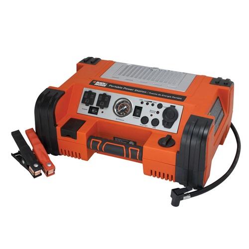

It gives me piece of mind to have this portable battery pack onboard, especially since I only have 1 battery. It has multiple features too. Had to use it once -- worked like a champ.
