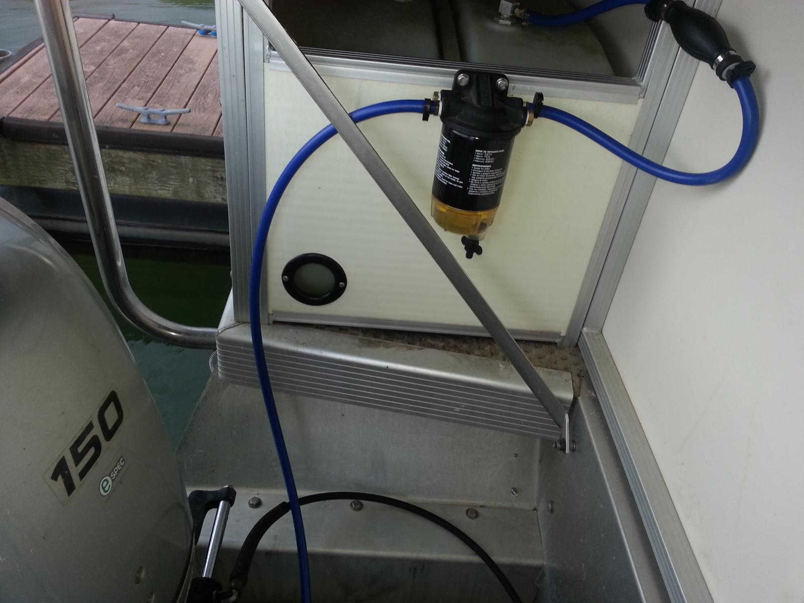

Pretty much all the water separator filters are the same just different brands. Our Honda didn't come with a external filter so I added one of these: You can see if there's water and it's easy to drain.

The Yamaha has a small fuel filter and water separator on the motor as well. It has a float in the bowl which is your sensor and alarm for water in the fuel. The large separator is a pre-filter before the engine and gives added insurance plus more capacity for water vs the small bowl on under the hood. The clear bowls under the large filters like cwags are nice! Just make sure they are mounted so they do not sit in water like in the transom area.
Speaking of that...my last Bennington had the separator mounted in the rear corner along with the battery cable terminal. My new one has it mounted under the rear deck in the transom. I just dealt with a pretty big problem with that set up getting water in the fuel and don't know why the heck they would mount it there! When i have time im looking into mounting it back where the other one was.
