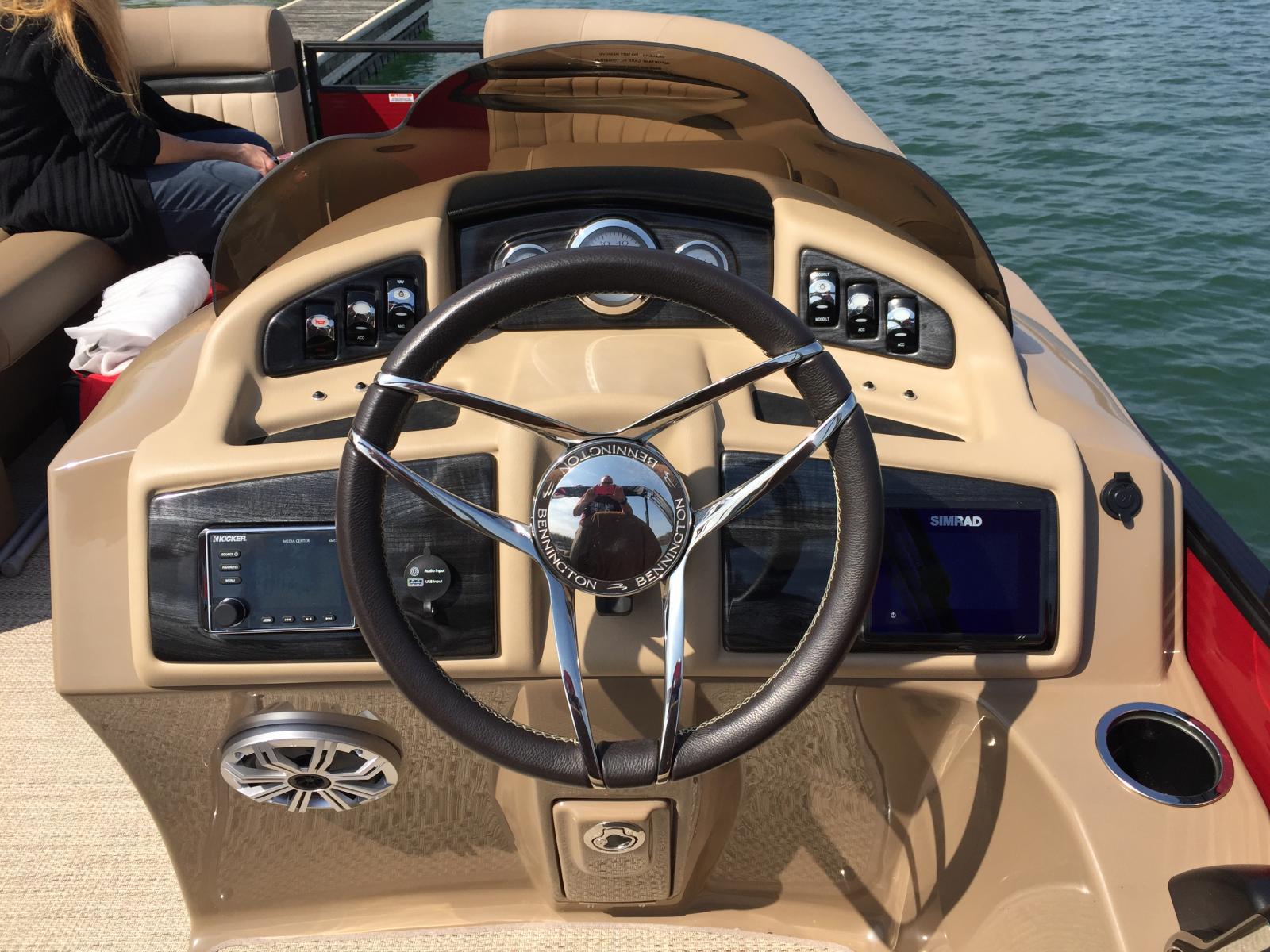

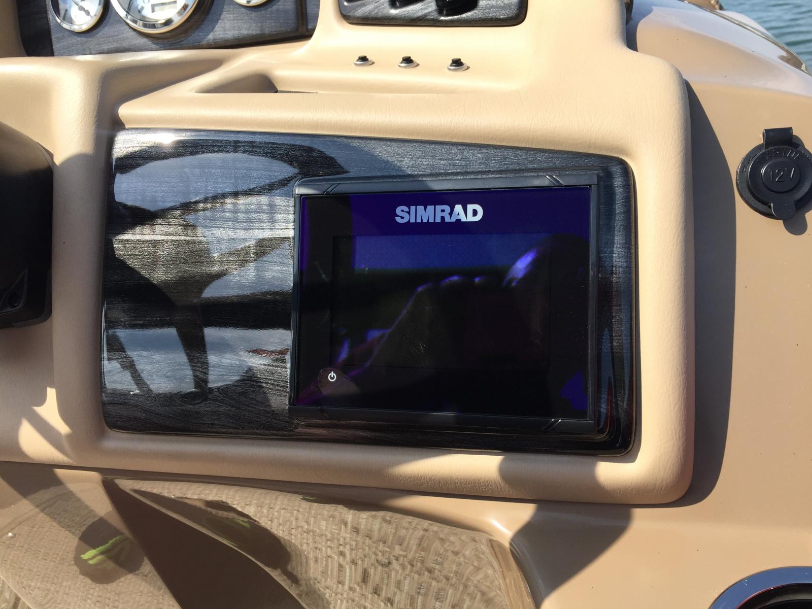

20180501_065129.jpg We got the Lowrance HD 7 Gen 3. My husband really likes it so far. Cabella's had it at 50% off, so we jumped on it.
We had the dealer mount it off to the side because it was going to block some switches otherwise. Seems to work OK where it is. Just doesn't look as clean as it could have. But it's at a nice viewing height.
Looks real good. I don't think there is a perfect way to make a "clean" install on a fish finder. The added benefit of a nice fish finder is worth it.
Nice setup and clean looking semper Fi but opinions differ. I feel with a flush mount you lose a lot of versatility. And if it's used actually as a fish finder vs a depth finder as you're driving , having it flush mounted would make it not quite useless to me , but let's say very unhandy at least. My opinion only and worth what you're willing to pay for it! :D
Yeah, I was just being an arse ..... :p
I definitely would have liked it at eye level, but it kind of balances out my helm with the stereo on the left side. I’m super anal about symmetry.
Haha! I still say you have an awesome set up but I'd need another fish finder to go with it that could be rotated and seen from other spots in the boat.
Semp..... that thing shines way to much!! ;) I can even see that guy taking pictures in steering wheel!!
We use it as a depth finder so it is handy to have it at eye level, especially with the shallow areas we have on the Columbia and Snake River. But having it actually in the dash just makes it look like it wasn't an afterthought.
