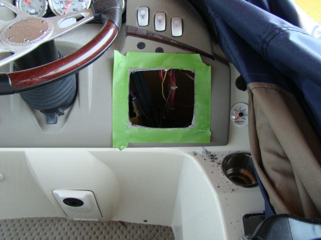

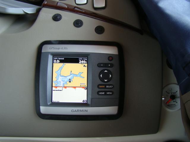

It figures, I had a working F85 sitting around for years that you could of had for free but finally tossed it a few months ago. But having had the F85 and upgrading to something new, I think I did you a favor by getting rid of it. There's just no comparison between old and new, the detail on new units is just so much better now it's really worth the upgrade. Installing a Garmin 551dv was pretty simple, I purchased an install kit online for $10 that had a pattern for the footprint of the 551. Laid it over the existing F85 hole in the helm and trimmed a little bit with a Dremel tool. Ran the new transducer, hooked up a couple wires, and it was good to go. The 551 is a semi-surface mount unit. It sticks out an inch or so, not flush like the F85, but looks and works great. The last pic is how I use mine with a split screen. The DownVu screen on the top half shows structure and detail while the 77kHz screen at the bottom shows fish arches as noted on the left side of the bump.

We put a 53DV in place of a 95. Easy to see, now bear in mind, ya’ll are running 30-40 mph where I’m at 10 max ... ;)
I now run a SIMRAD GO5 and other than fish ID, it’s awesome!!!
Thanks for the pics, looks like it fits in there nice. I’m only running about 6 mph faster with my little 70 on a 20 SFX. Perfect for us in the shallow bay we are on. I didn’t realize there were all these choices for a depth & fish finder/gps unit. But I need all the help I can get, I had a few times where I ended up at a totally different spot than where I thought I was and only realized it because of the depth readings. I’m giving myself plenty of time to make this decision as the shrink wrap won’t come off until April. I hope by then I’ll have over-thought it, over-engineered it and then I’ll see someone’s set up and decide that’s what I want. Once again thanks for the info.

Finally decided on a Garmin 54cv to replace the Garmin 95. Thanks for the input and pictures. Other than a chunk out of the panel and a scratch because I got distracted while running a power tool, it was an easy conversion. Of course the 20 foot transducer cable that came with it was 6 inches short so I had to get the 10 foot extension.
