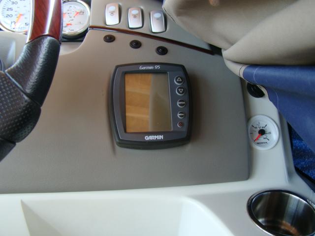

I do our impellor every 5 years. I also have a water pressure gauge so I can keep an eye on it's performance. You should also change the lower unit gear oil and remove the prop to check the seal and grease the prop shaft. Gauge is on the right.
