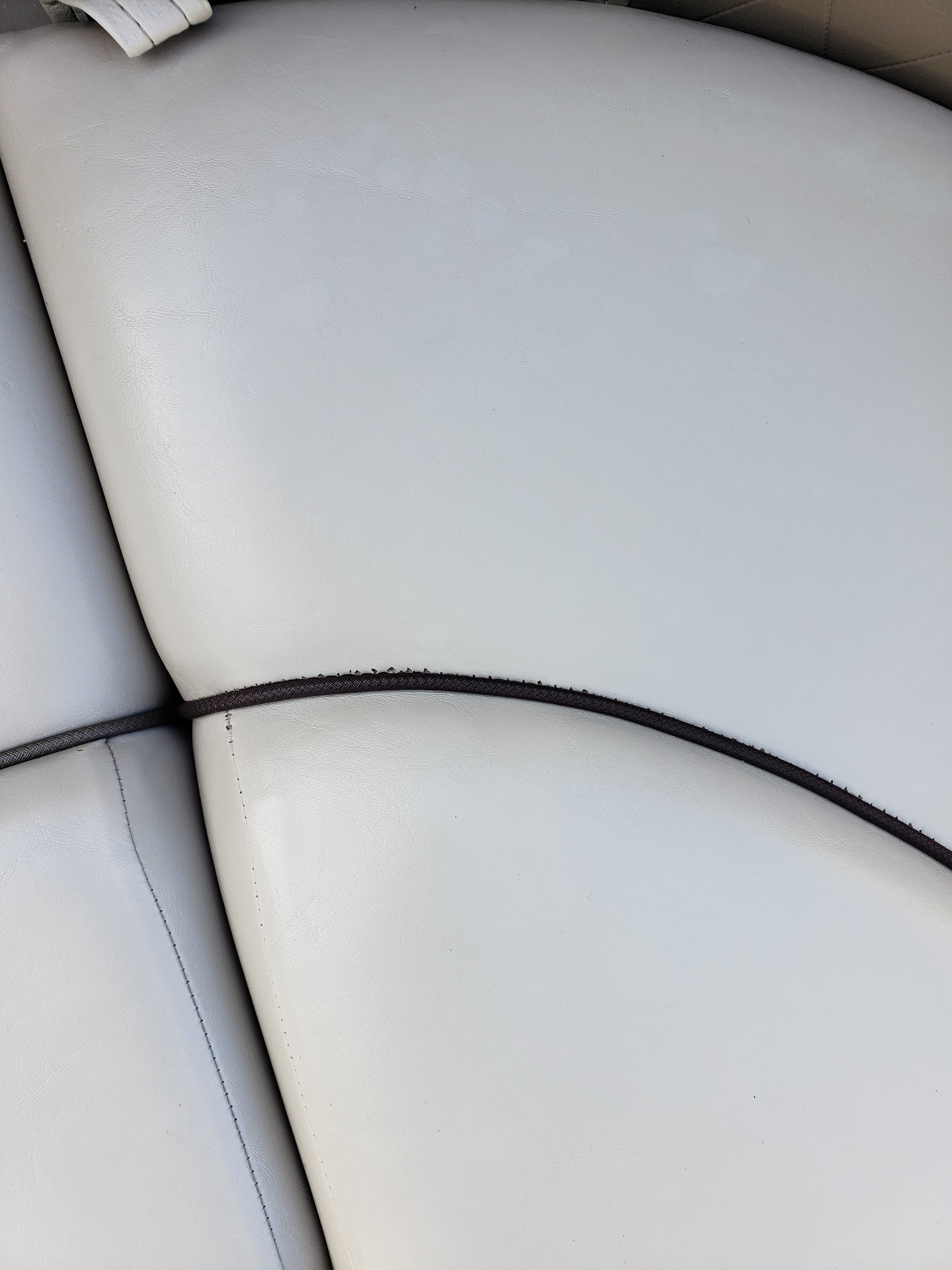

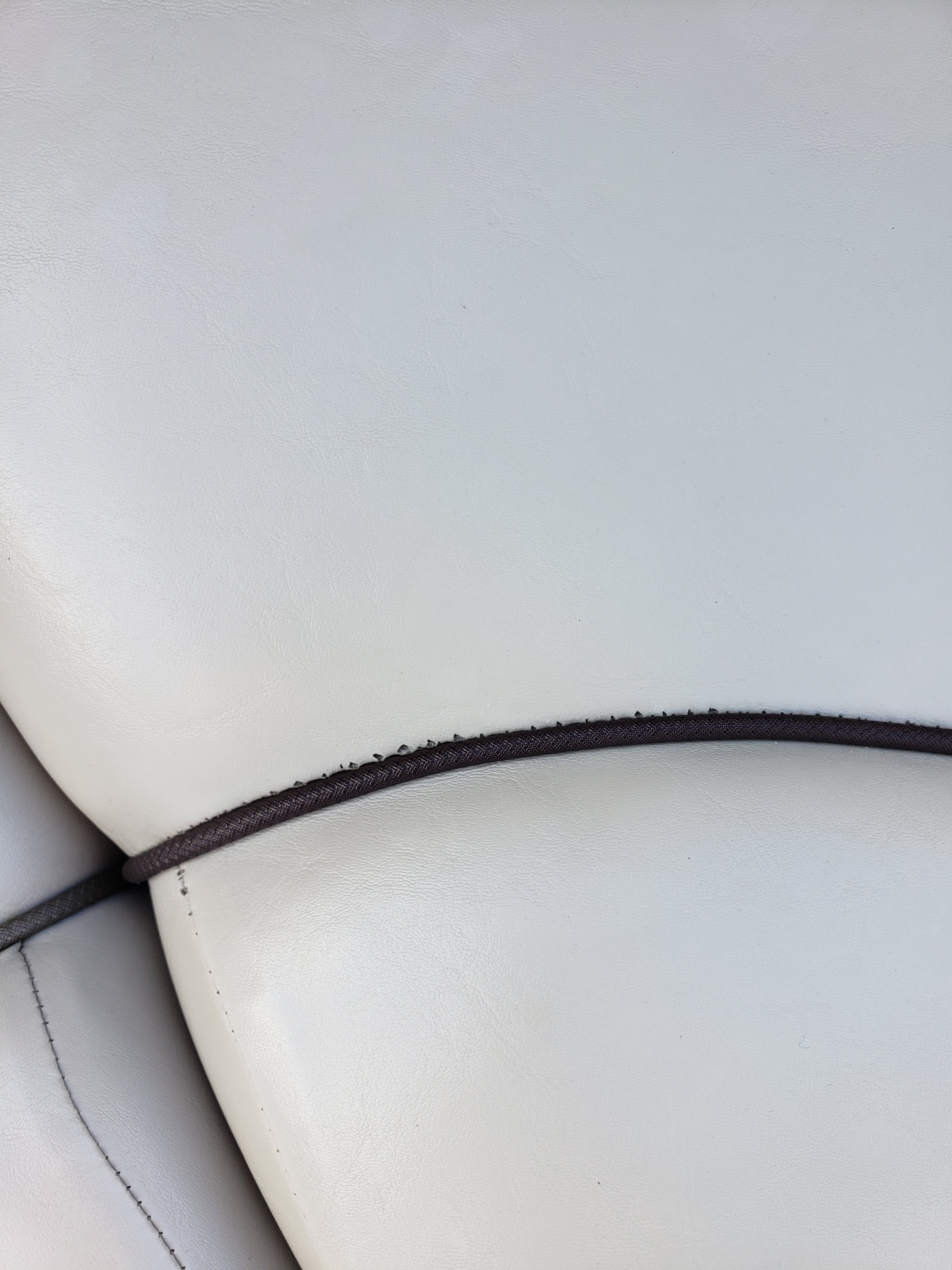

One of my seats is beginning to separate along the stitching. I will attempt to attach pictures. I plan to reach out for a warranty replacement. Has anyone experienced this before? Also, any issues matching the vinyl with replacement on a 3 year old boat?

The problem is/was the Foam. When the foam breaks down, the seat skin stretches way more then it can handle.
If you replace the skin it’s only gonna do it again.
The fix is you need to to swap out the foam with new High Density foam. This way the seat will keep its shape.

Thank you for that info. I will request/insist that the entire seat cushion be replaced.

We also had the same problem on our 2012 rcw. Got it fixed under warranty . No Problem with matching colors in my experience. Bennington sent us completely new seats (new skins and foam for front corner seats). But the same problem happened about a year later. I don't think its always a foam problem but do agree it can potential be the problem. My boat had 30 hours on it and 2 years when it first happened. I think it's mostly in the material and sewing. But that's why Bennington has such a great warranty. Only problem is that it takes almost an entire season to get warranty replacements sometimes, so do it sooner then later.

I have experienced this same problem on a 2008 Bennington tritoon. I took all the seats out to an Amish reupholsery and there was enough material to stretch and re-sew the seams. He said he sees this on a fairly regularly basis. He said often the material is not good enough to repair but luckily mine was. Cost $400.00. It was a lot of work to take the material off on all the seat cushions. That was the only place it was doing that.
