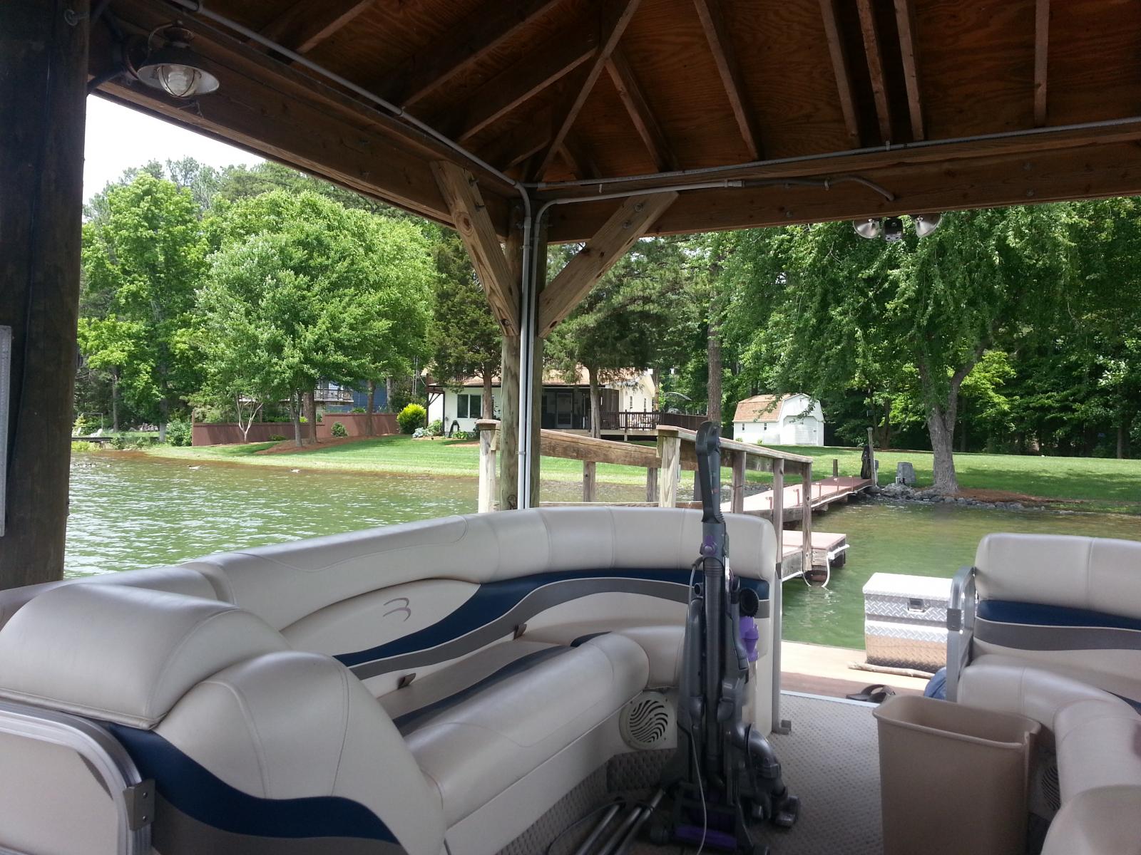

Hey thank you for the link. Here is my Delma. The Dealer wants like $300 per cushion. I need to replace 3. The foam is completely broken down. So the skin and the foam need to be replaced. The link provided sells complete furniture for like $400. (That’s for the entire piece) in my opinion the Vinyl on our bennington is not the greatest.
My Air Nautique is 17 years old and the vinyl still looks like new. And to be honest the Air nautique has taken a lot more abuse then the Bennington ever has or would. So that brings me to my question? Would it be better for me to source my own Vinyl & High density foam that may or may not be a match for stock colors and have a local Upolstry guy Rebuild and Upgrade my current stuff or just template what’s damaged with factory stuff. My boat is a 2012 and my fear is I will be dealing with the exact same issues in another 5 years of use? If bennington has up graded the vinyl and foam then stock may be the answer but if everything is the same then I think aftermarket may be the ticket. Your thoughts
Below is a picture of one of the seat cushions that’s breaking down/falling apart

That looks horrible. I hope they have improved it since then since we have a 2017 with the Semtex. If mine is looking like that in six years, I will be most unimpressed. Too bad yours isn’t still under warranty.
I have a 2013 GCW and my vinyl still looks brand new. So much so that when we have friends on the boat they are amazed at how good it looks. My 2013 had a 7 year bow to stern warranty and I think that included the seats. Have you checked with your dealer to see if the warranty covers the damage?

The pic above is from 2016 and I purchased this Bennington in 2006. The vinyl was in mint condition. The boat was always covered.
