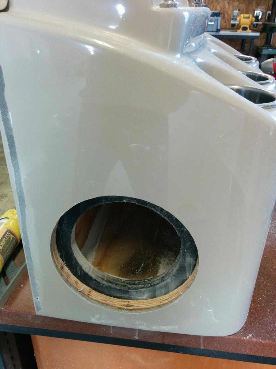

A sealed enclosure was fabricated and installed inside the port side table. To prevent issues with excessive table vibration, stress, etc., the Wet Sounds SS-65 sub was mounted to the new internal box and not the side of the table. The box was then fastened to the boat floor through the table wood floor. A template was made to cut the holes with a router.
A Wet Sounds Rev 8 speaker grill was then modified and mounted to the table to protect the sub and finish it off. Black rubber weather-stripping was used to fill the minor gap between the grill and the subwoofer. This mounting method also allows for the proper excursion of the subwoofer behind the speaker grill.
Very cool, and incredibly well thought out.  Very impressive in form and function!
Thanks! As you can probably tell, my buddies and I have a tendency to 'over-engineer' things...
