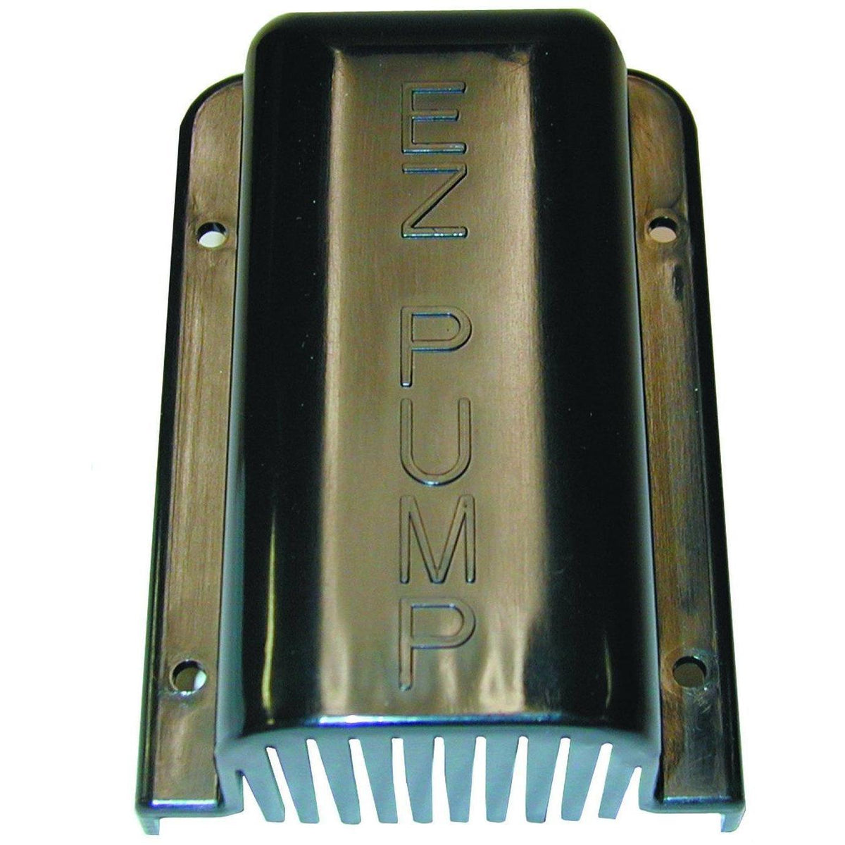

That’s how mine is Dan. When at speed it creates and air pocket down there. I saw a scoop (in the photo) and thought about mounting on the bottom of the box bracket and connecting to the pump but I might have to swap the pump too

That’s an interesting idea. But be sure the scoop sits below the bottom of the pontoon tube. Kinda like the issue with the Transducer. My transducer was set too high so it would stop working once at speed. Getting it lowered mostly fixed the issue.

I was searching today for a solution and came across this....
I think I could mount on the livewell pump bracket and switch to a through hull pump. Have one on order and will know soon enough.
