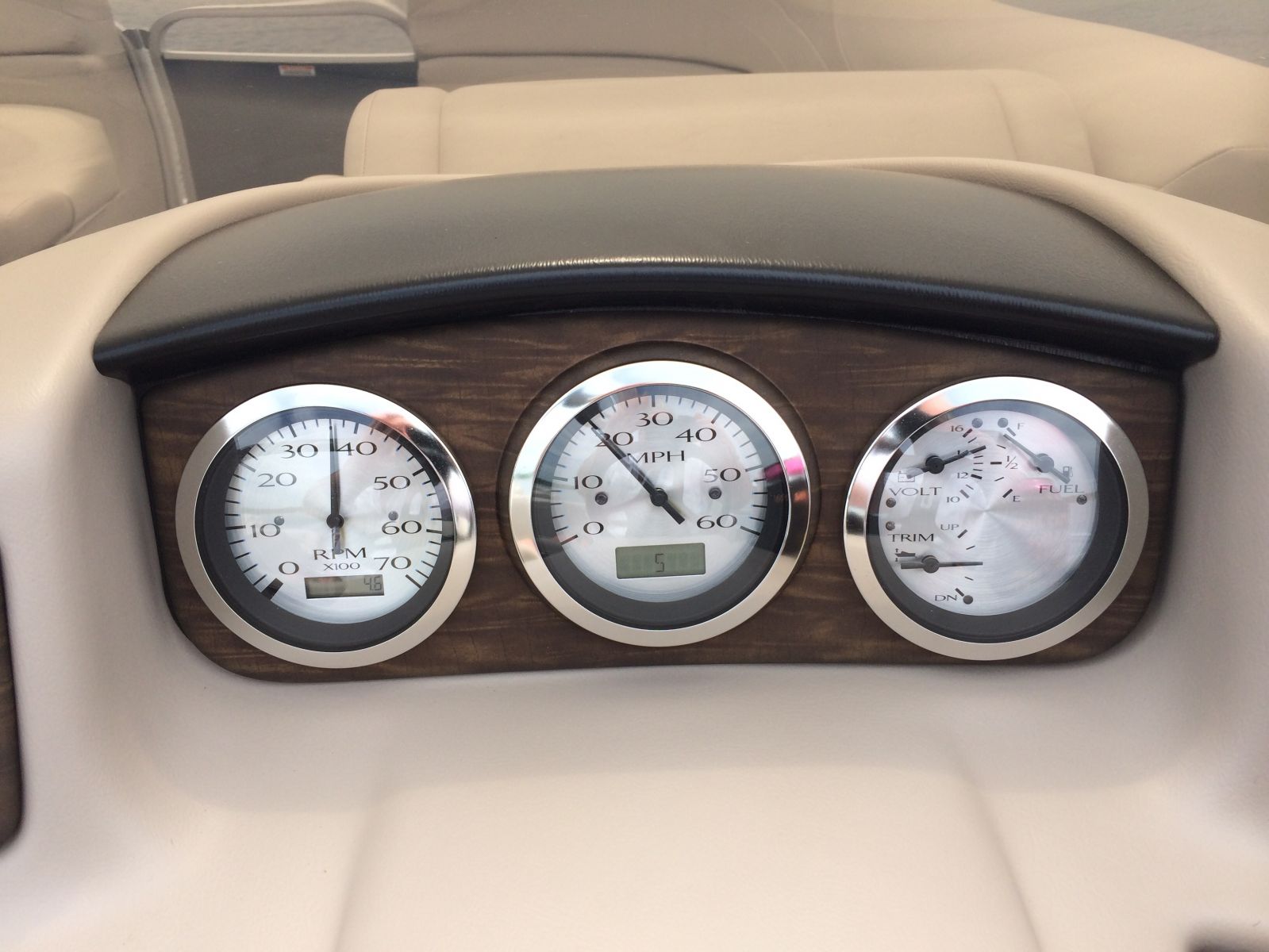

The aluminum prop that I will remove tomorrow was not a bad fit for the boat. With just a couple of people onboard I was always able to see about 5900 RPM and 38 mph after cleaning the toons. Favorite cruise speed when we're just out and about has been:
I'll be interested to see the difference here and it the top. :p

So far performance is similar and with the water temps running in the low 60's I'll need a warmer day before I get in at the beach to clean the pontoons so I can have an accurate look at the top end and speed at a few key RPM's. Coming back in from skiing with 3 adults and a couple of kids in the boat I saw 38 mph at about 5800 rpm's trimmed out about 3/4's of the way up the gauge.
