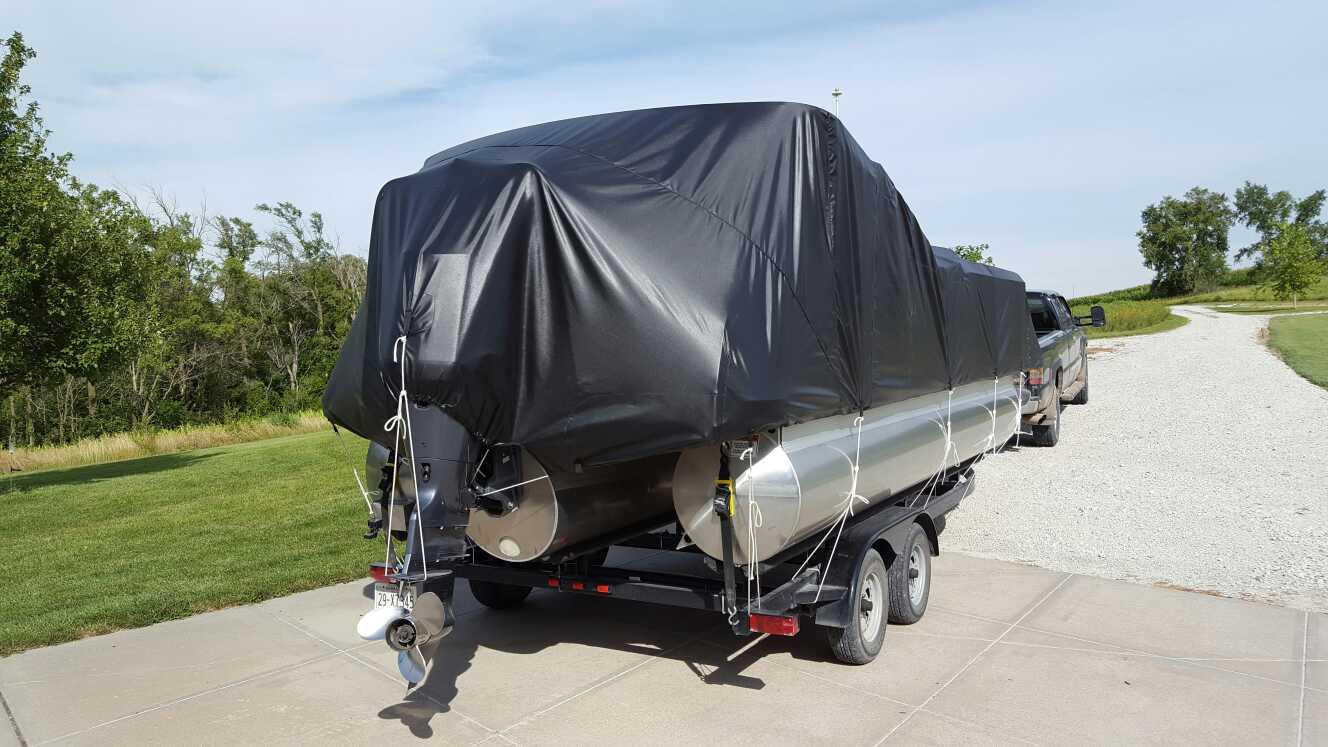

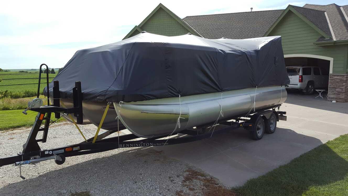

The factory cover is not meant for towing, so if you want it covered a canvas shop could make one for you. There's a few on here with some really nice ones.
Much less stress towing with motor all the way down. That's how I always towed my pontoons, never had a problem. I always checked the first couple times in and out of my driveway to see how close it was. The trailer had 14" tires and it was more than enough clearance.
What will be different about a canvas made for towing vs the current canvas from builder?
It goes down further and is more secure so there is no wind getting under it.
Cover off and motor trimmed down to where it is being supported by the trim rams. When I towed mine 1300 miles I had it shrinkwrapped but it started failing 1100 miles in.

Our towing cover snapped under the deck. You would not have been able to install it at the dock. It also used a waterproof material. It weighed probably 3 times the mooring cover. Being waterproof, you had to make sure everything in the boat was dry before installing. The covers are for different applications. If you load the boat up for a long trip and want your stuff dry upon arrival, get a trailing cover from a shop that understands your needs.
