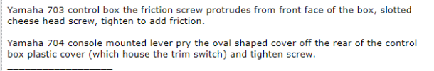

throttle cable tension needs tighten up at your control box. You show have a access panel below your throttle control.
