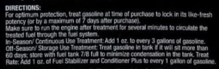

I would double check the dosage for your fuel, seems like 1 oz per gallon is a lot. I use StarTron and it's 1 oz per 8 gallons of fuel and says that over dose causes no harm.

I thought it was a lot too when I read the directions. Below is what is states on the back of the bottle.
That's what I used on mine all the time. If you also already use it regularly (the In Season dosing of 1 to 3) I just added the difference, so an additional 2oz for every 3 gallons. I did always fill the tank right up, add the stabilizer at the station so it has the drive home sloshing around to get a good mix, then run on the muffs at home to warm the oil and pull in the more potent concoction.
I changed my fuel/water separator every year, not that expensive to be sure the whole setup is clear of water. Do it before you run on muffs and you can be sure it is full and treated as well. You can always use the water paste to check if you have any water in the tank. We used to have a gas station and always dipped our tanks as common practice to be safe.
