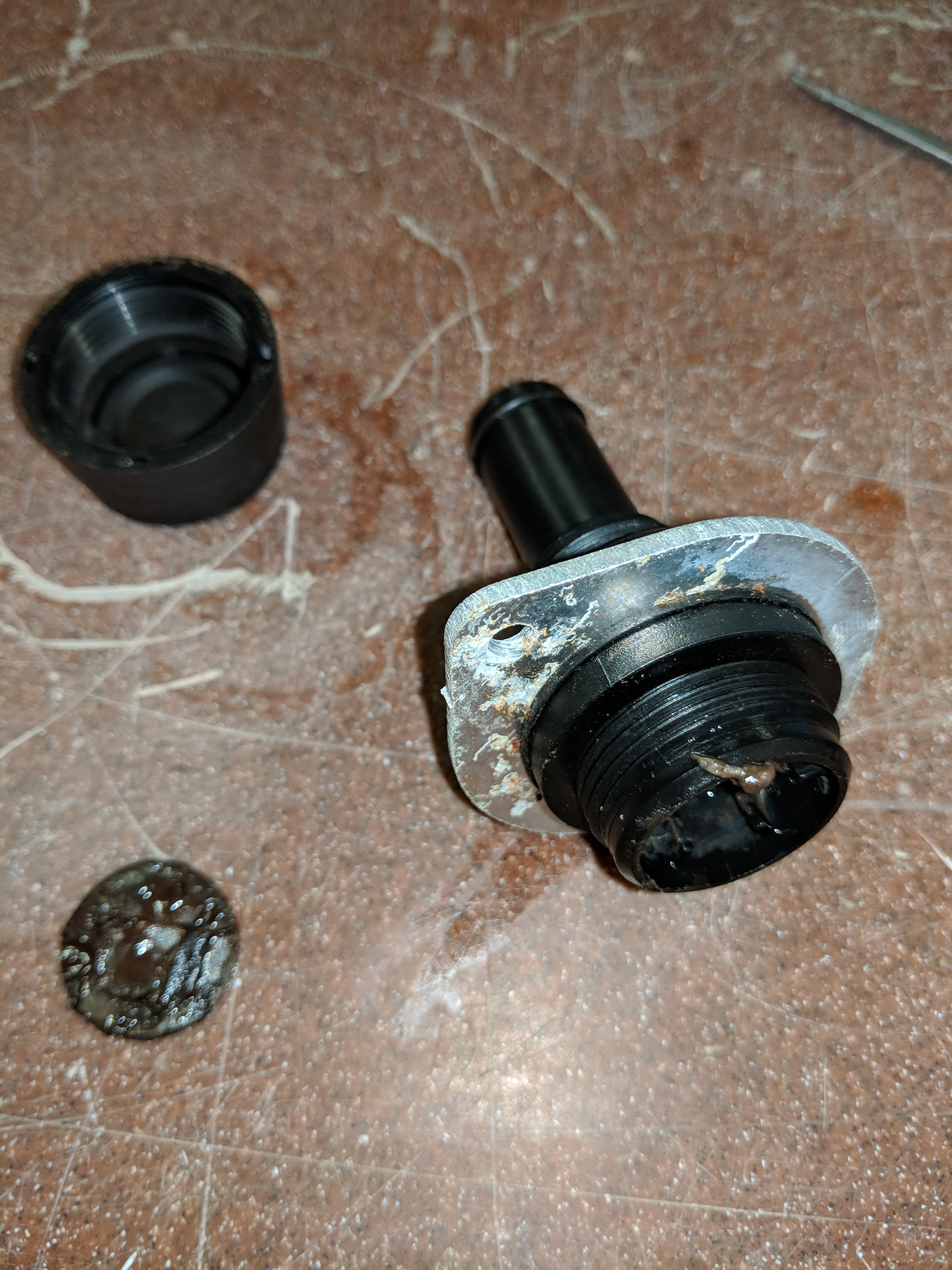

Vent hose deck fitting removed and disassembled. The cap (upper left) screws off to expose the screen (lower left). The screen was completely clogged with a residue, preventing the fuel tank from venting. This caused the fuel tank to suck in and the motor to eventually quit running.
