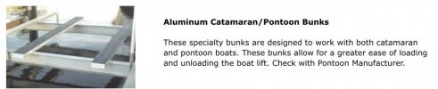

Great! Thx!! looking for something like this...View attachment 30275
Those are my aluminum pontoon bunks that I temporarily installed on a neighbor’s lift while my new dock and lift were being built. They are from Fix Marine in Cape Coral Florida. The bunks were included in my dock and lift package. I’m very happy with them.
I see them on Fix website I think.. This?
"ALUMINUM WALKBOARD 10 IN X 12 FT" ?
And would the 12' length be ok for 21' logs? Really appreciate the info!
Bennington has not been very helpful. Thx! John
Go to this website for details on the pontoon bunks. I will measure mine when it stops raining.
