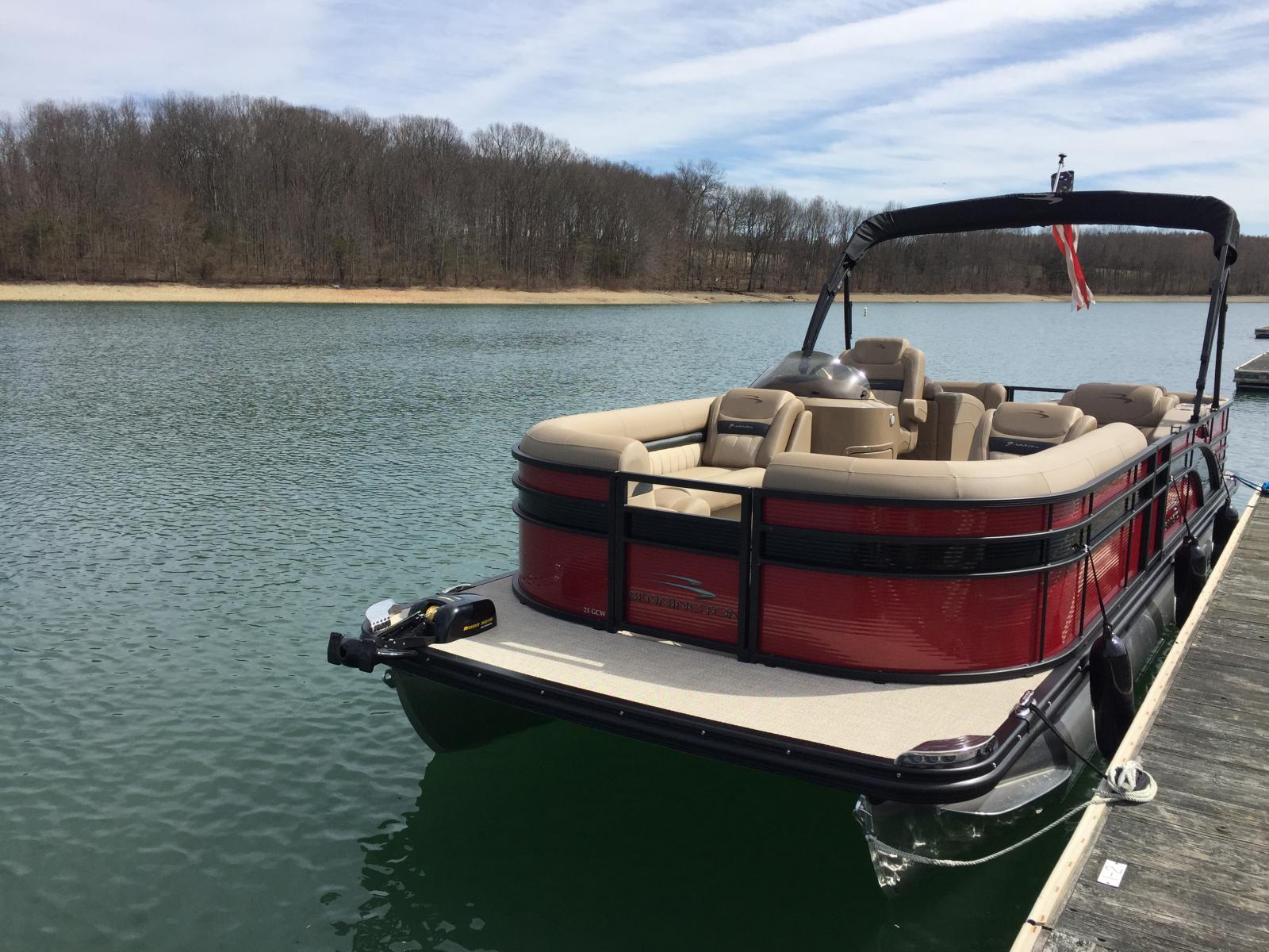

The pic above shows anchor stowed. We have the DH40 with remote and I LOVE IT. It pulls up our navy anchor with chain and locks it in place like above pic. Only touching of anchor is to clean mud off. It has an switch on back of the housing. I use remote till I hear the chain. I then go to front, swish anchor around in water to clean, then hit switch on housing to finish stowing. Easy peazy ..... :wub:

Old post but.. I have a Deckhand 40 "pontoon package" and it works well with a 25 lb river anchor on a 20 ft pontoon. The spool is not large and holds about 100 feet of rode. If your in 20 feet of water, most of it should be deployed for solid hold on a windy day. With a 25-40 lb anchor, it automatically pays out line as needed or until you lock it with a momentary push of the "up" button. For my next pontoon purchase I would like to find a cleaner solution. Mine is mounted on the front deck and the claw type river anchor works super but in the stowed position it looks like a battering ram on the front of the boat.
A low profile under/thru deck solution would be cool but I have not found anything yet.
3fletch: The DH40 requires an anchor with a round solid barrel in order for the "flip up" feature to stow correctly, It won't handle more than a foot or so of light chain (it comes with a short piece), lots of pics/video's on the web. The "pontoon version" came with a base plate that allowed me mount it on a pontoon that has only a few inches of deck in front of the playpen. Even with the plate I had to mount it at an angle.
Actually I have a 28lb "Navy" anchor and it stows properly. Depending on your model, the fronts have more deck space so it can be mounted straight like mine.

Hello club, I am a new"ish" bennington owner, 22 ssx and I have been trying to find information on how to wire in a Minn Kota deckhand and came across this thread.
I see a couple of you posted pictures of exactly where i am planning on mounting mine, but how did you wire it in? There are a couple of wires right under the bow on the starboard side that I thought I could use but I get no power to them no matter what switch I flip. Did you run wire back to the batteries under the boat and go that route?
Thanks for any assistance
You’ll want the optional helm switch. Run 12/2 wire back to battery through m brackets then across to battery side (if like mine). Takes about 32-34’ of wire. Those leads go to circuit board (Ground) and power goes to breaker on unit. Hot from breaker goes to circuit board. Helm switch goes to circuit board. Easy to wire. I just replaced my circuit board. Was having issues and it finally crapped out. I knew it was the board cause I could hot wire motor and it would work.
