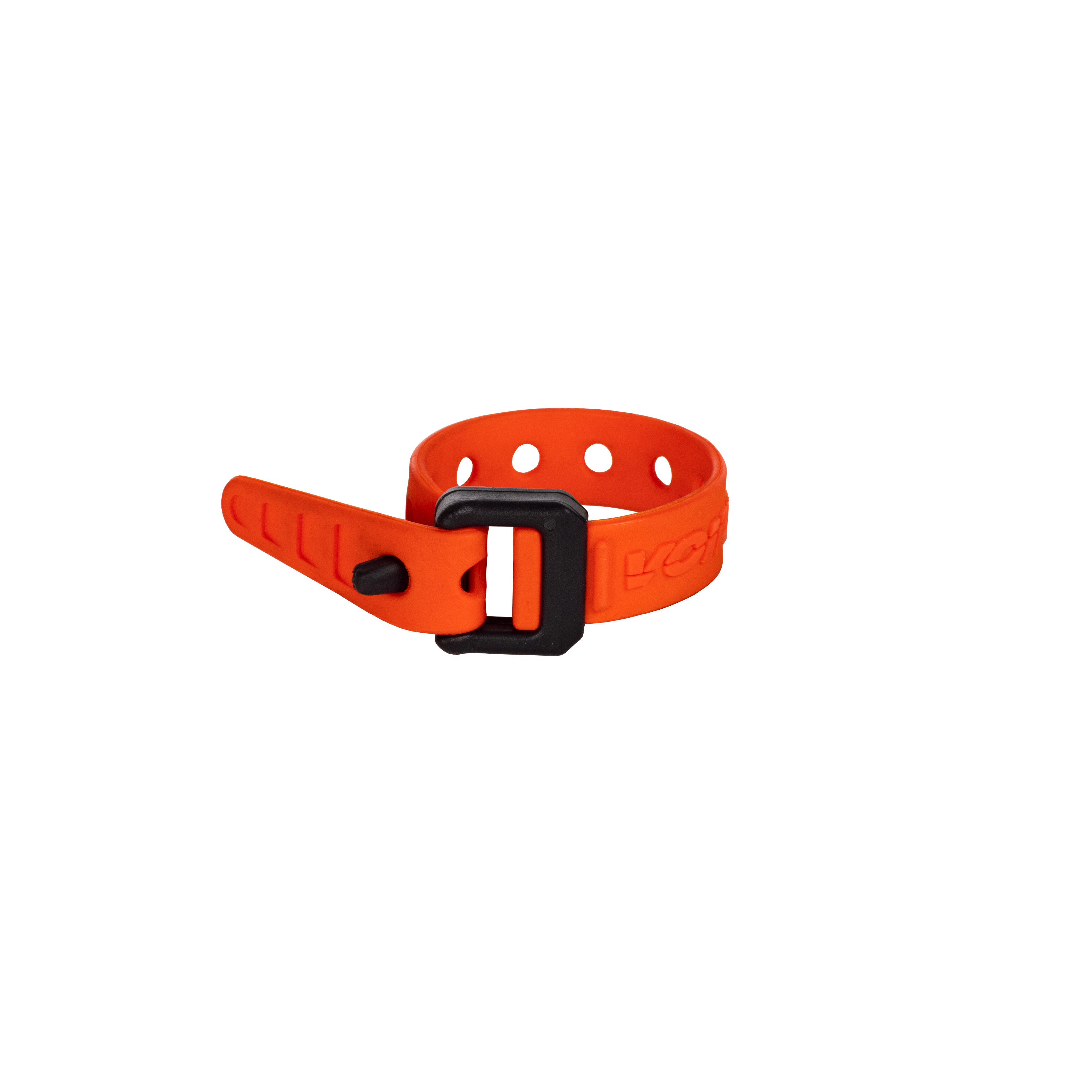

I use these Voile straps on all my bimini clips. I use the smallest 6" size, or possibly the next size up, slip it under the whole clip assembly, and attach it. These are the best straps, use them for all kinds of stuff on the boat. I didn't install the pins when I installed the front bimini because I didn't want those cables just dangling when they were not in use. Plus, it didn't seem like they would hold as well as something that fully captures the plastic and the full bracket.
do you have a picture of this installed on the bimini? I'm having trouble visualizing. Always open to other suggestions to enhance safety!

But the Voile strap essentially gets inserted under the bimini clip assembly, (and above the bracket) and wraps around the whole bimini clip assembly, then fastened to itself, securing the bimini clip to the bracket pin. So even if the bimini clip tab failed, this would hold it.
One thing to remember about these black plastic bimini clips, is they have the tab you use to release it from the pin. But it is important to use the tab when you are engaging it to the pin, also, otherwise they will just get loose, that much faster.
The nice thing is these Voile straps are rubber, so they have some give. Unlike a fixed metal pin, they will give slightly if say a big gust of wind came up unexpectedly and it may not tear out the arm from the fencing. I don't know the difference in strength between the metal pin and these, but I have never had a strap fail. And since they are so low profile and simple to use, I find myself using them for everything. My rear bimini did not have the securing pins, but that may have been because all those clips head the right direction, they face backwards, so wind and forward momentum will likely make them tighter against their bracket. (Like the one in the photo below.)
But the new front bimini clips face forward, so wind and forward momentum are pushing them away from the bracket pins.
But I put Voile straps on all eight of the clips, just to be absolutely sure.
