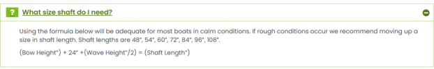

For Fishing/Crabbing - looks amazing. Sorry, no first hand help - but I did see this FAQ:
Given these Toons are windsails, the 36V with a LOT more thrust (55 vs 80 vs120) would seem the right answer and again consistent with the FAQ recommendation. I could not find out if the system works on Lithium...I would pass if they do not. Lighter and a LOT more power.

Thanks Laurence - I have that same formula....but receive conflicting advice at is applies to Toons...more and more are on the water holding fixed positions and the performance opinions seem vary depending on what motors are in stock/sponsored by the marinas I've asked. Part of the reason I popped over here....cost more to ship crabs to LA that to but them there lol....we get plenty that's for sure. Rarely coming off the water without at least 3-4 dozen, usually closer to 6-10.

As far as shaft length that has to do with several factors including where you're mounting it and what kind of sea state you expect. If you're trying to hold in 3 footers while the trolling motor is bow-mounted you might need a 72". But in calm water a 60" might be more than enough.
Power is partly a function of the the conditions you'll be facing, but also your available room for batteries and of course budget. More power requires more volts and/or reserve capacity. Again you could probably get away with a 24v setup with a single lithium or two small lead batteries, but in a snotty environment a 36v setup might be required with more batteries for all day trolling.
