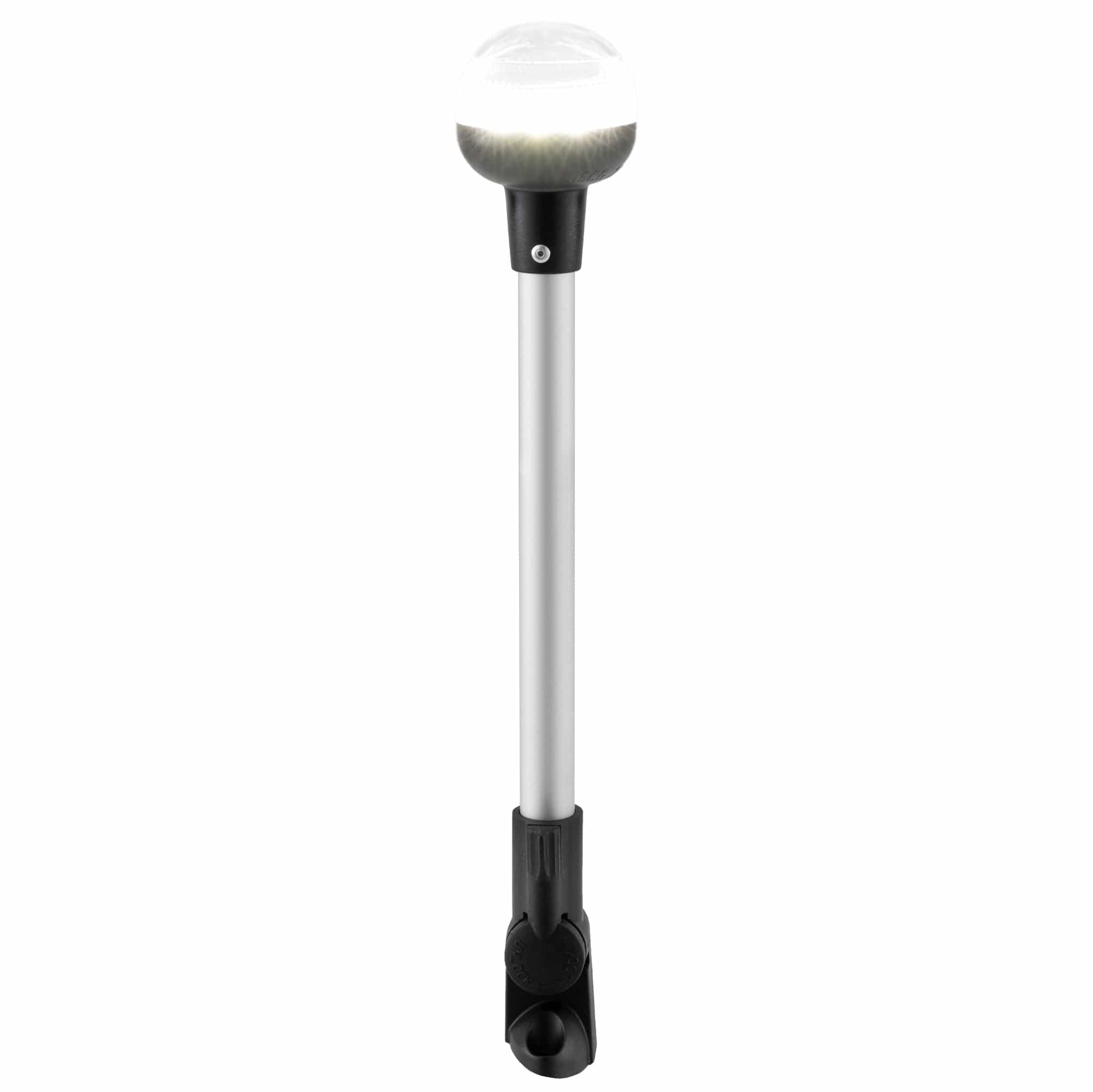

The base on mine was replaced a few times by the dealer and I finally just swapped it out for this one. Works best if you put it in one position and leave it alone.
