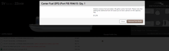

If you feel that the F200 will provide the top speed range you are looking for if you regularly have 1-4 people riding (expect noticeably lower top speeds with more than that number of people), then it may be a good cost compromise to save the money versus the VF200, then erase that savings (haha) by going with the 22SVSR optional 46gal fuel tank:
Here are the MSRP price comparisons for the 22SVSR with the SPS and either the VF200 or the F200+fuel tank option (no other options selected):
4.2L - $44,693
2.8L + 46gal - $44,363
If you want to go all-in with the VF200 + 46gal tank, then MSRP is at $45,972 (again, no other options selected).
