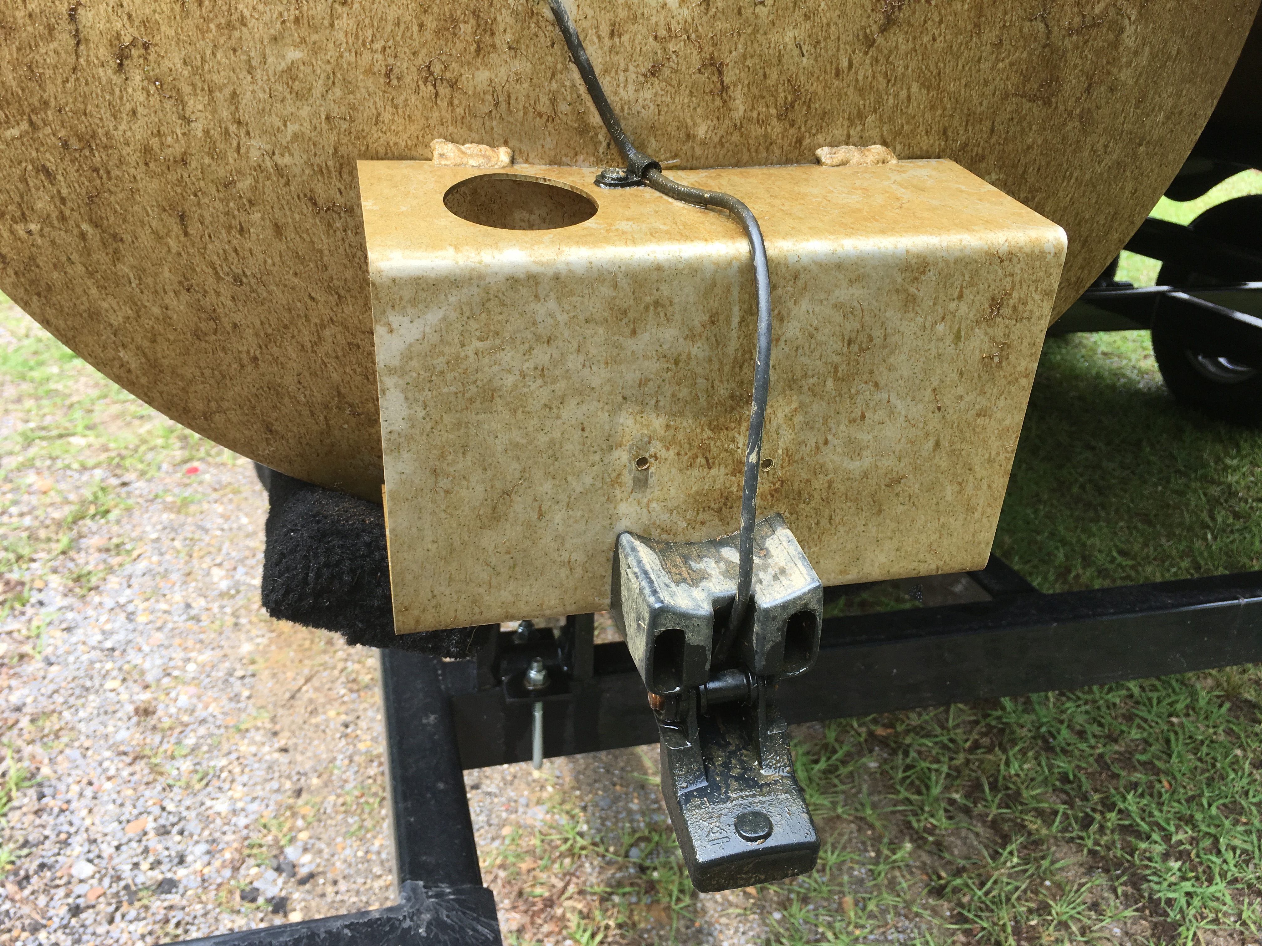

I had same problem on my previous Bennington. Garmon Echo 101 stopped working around 10-12mph. I lowered transducer and problem solved. In the pic below the two holes are where it was mounted prior to me lowering it. No comments about the dirty toons:)...this pic was taken the day I sold the boat.
I moved mine down (but not quite that far) and out. Looks like there is a wide range that solves that problem.
