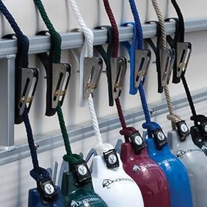

May I suggest Tidy-Ups?
They don't require any drilling at all and are REAL convenient.
I used to use those.
They had an unfortunate tendency to fall off when you weren't watching. PLUS you have to tie a knot in the line to raise the fenders and untie it to lower them.
I originally resisted buying Tidy-Ups as an unnecessary extravagance, but I was wrong. Very wrong.
This picture is from Amazon, but you can find them at pretty much any marina:

This is exactly my problem with the 2574 GCW. No where to mount, but on top of the rail since the fence goes all the way to the top of the rail. No space in between for the Tidy-Ups (which I like the concept) hence, why I chose the EZ-Fender. I could say this is a design flaw in the Bennington, but I really love the boat.
