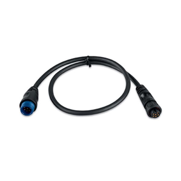

Problem is, the Garmin 90 you have (labeled Fishfinder 95 for Bennington) used a 6-pin connector from what I can tell here:
The current dual-beam transducer that Garmin manufactures is either a 4 or 8-pin connector:
You could try finding adapters so you can continue to use your old 6-pin depth finder with a new transducer:
But being the cheapo that I am I'd try splicing first.

Not sure what your search will produce but if you end up trying to Macgyver something maybe the below chart can help. Seems like any transducer will have a series of color coded wires you might be able to splice into the existing i put cable.
This is from the Garmin manual for a splicing block used to convert a 6-wire setup to an 8-wire fishfinder.
