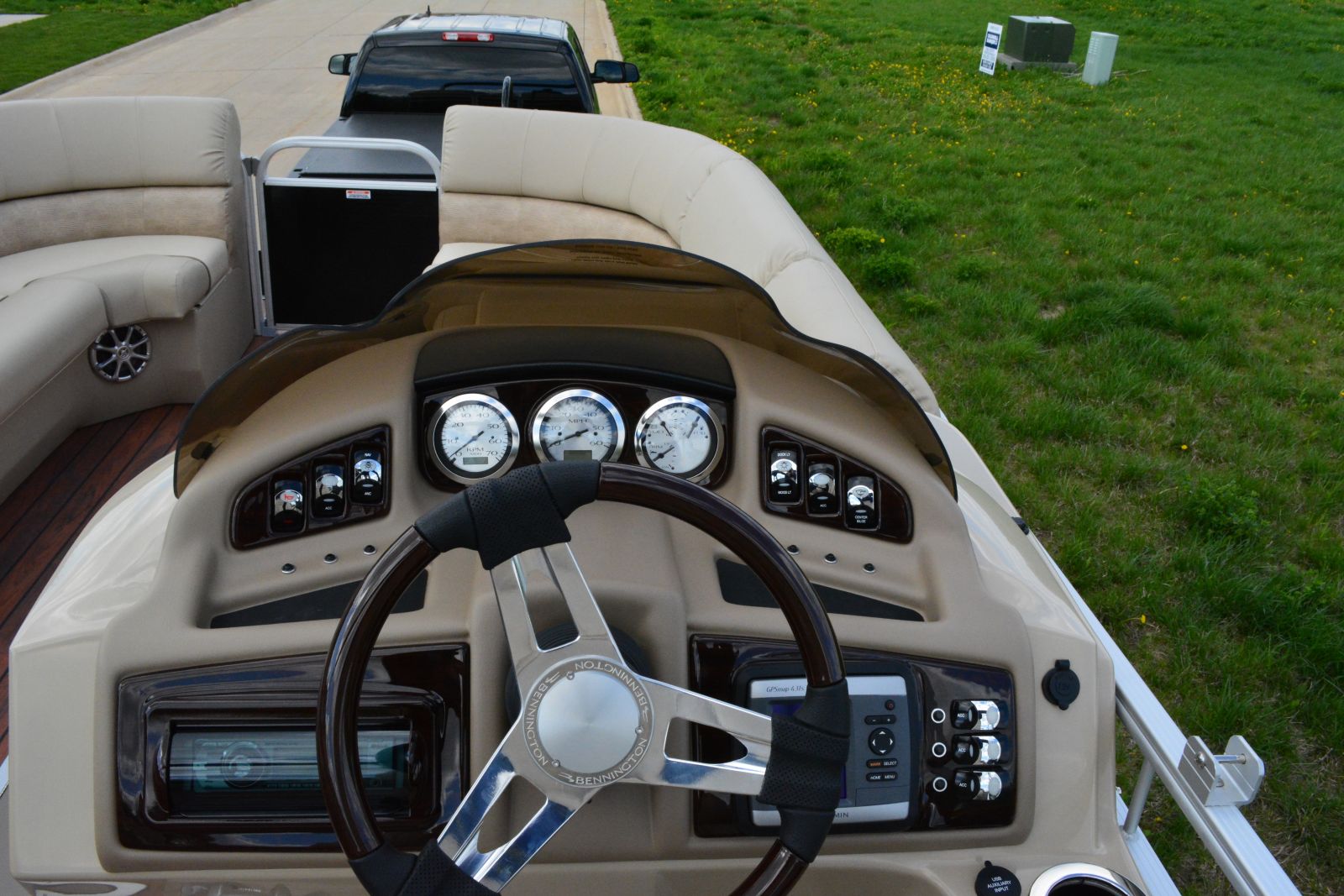

Interesting. Is your hour meter located within the tachometer? Is the hour meter part of a Yamaha gauge package?
full
It's a digital display
