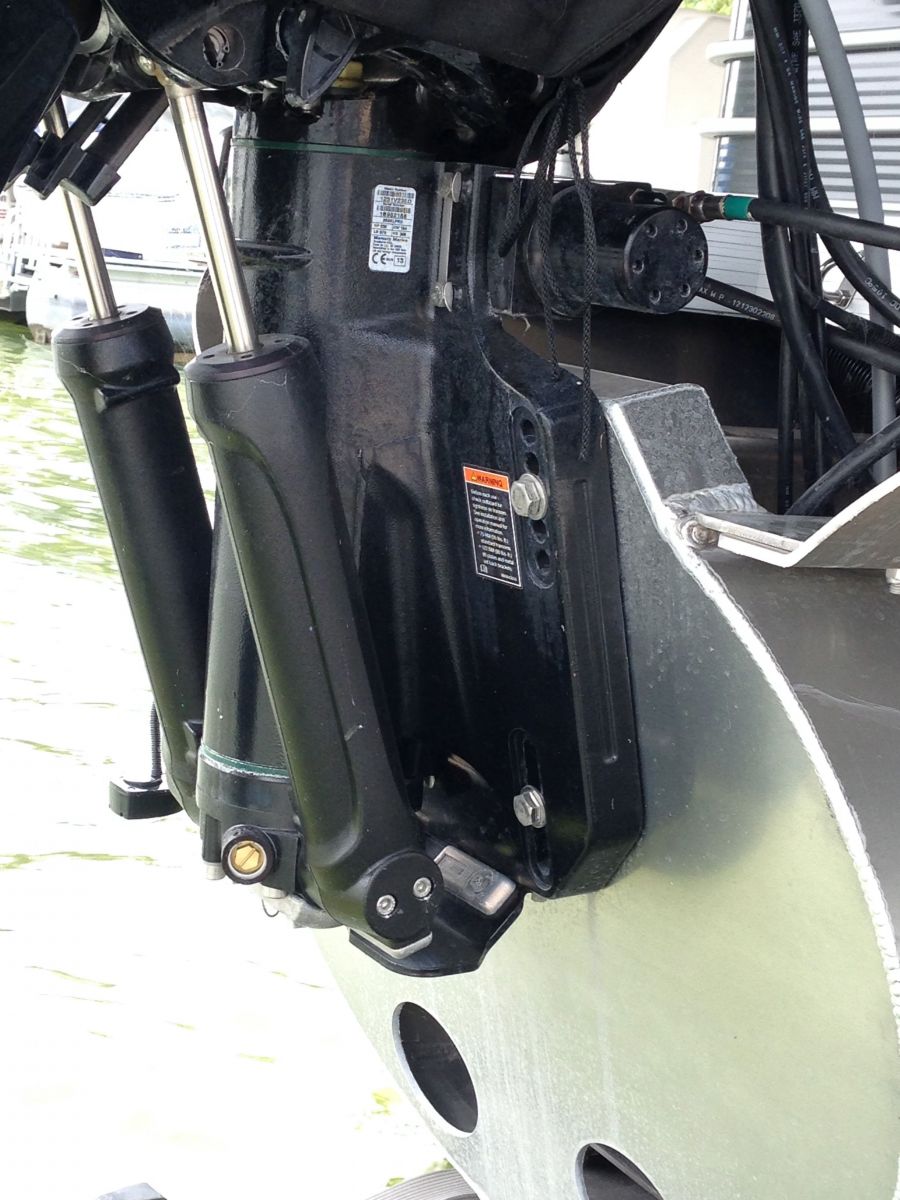

13p is way too small. Were running a 24 ft tritoon w 225 merc. 14.7 x 16p at 46 mph @5800rpm. We were full of fuel and 5 adults. I still thi k im going to go w a SS 4 bladeFor comparison purposes, my 2574 with a 250 Verado Pro spinning a 15.6X13 Enertia and mounted in the top hole/lowest position will hit about 40 mph @ 6400 rpm moderately loaded. Obviously, I could probably do a bit better by going to a 14 or 15p but I'm pleased with my overall performance.
Yeah, I agree that I'm under propped but unfortunately I didn't know better when I bought the boat. Worse yet, the next one's on me...13p is way too small. Were running a 24 ft tritoon w 225 merc. 14.7 x 16p at 46 mph @5800rpm. We were full of fuel and 5 adults. I still thi k im going to go w a SS 4 blade
Let me know if you decide to move on from the 13p Enertia, I may know someone who would take it off your hands. Not that I need to own another prop.....Yeah, I agree that I'm under propped but unfortunately I didn't know better when I bought the boat. Worse yet, the next one's on me...![]()
Actually, I recently contacted Ken @ propgods.com and provided him with all my critical information and he recommended staying with the 13P! Over the weekend I also talked to someone with a 2575 RCW with a 250 Verado. While he couldn't tell me exactly what pitch he was running, he thought it was a 15 or 16P. He did indicate a top speed of 40 MPH with a WOT 6200 RPM. As such, I'm feeling a lot better about my current set up!Let me know if you decide to move on from the 13p Enertia, I may know someone who would take it off your hands. Not that I need to own another prop.....
