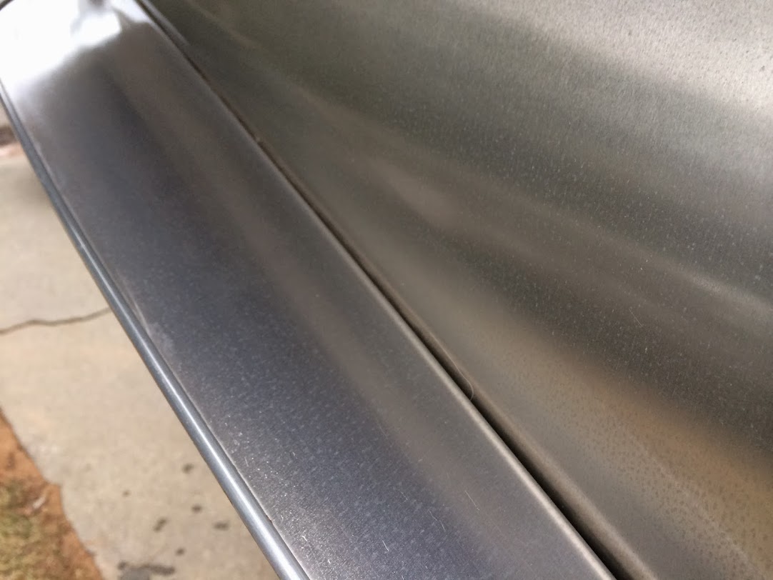

Hey guys. I just took delivery on my new 22 SSX on Friday. I'll be sure to post up lots of pics once I get it out on the water here in a couple weeks, but in the mean time I'm hoping someone might be able to give me some advice on cleaning my pontoons in preparation for sharkhide.
I've scoured through all the threads here and around the web that I could find on the subject, but I'm still not sure. My boat is new, supposedly never touched water and stored inside the whole time. But the pontoons have lots of spots and streaks running down them. We tried cleaning them today, first with vinegar and then with 'The Works' toilet bowl cleaner. The vinegar seemed to do nothing and The Works, while it definitely got them cleaner, did nothing for the spots and streaks. I don't care about polishing, but I'd like to get them looking really clean and new before I put on the sharkhide. Are we being too picky or something? I would have expected this stuff to be easily cleanable considering it's a new pontoon. Thoughts?
Pics (don't mind the handprint):

Ours where like that as well, i think it is  the oxidation process in it's early stages. I washed ours with car wash soap, rinsed well and wiped down acetone to remove any oily residue. (like hand prints) Then applied 2 coats of sharkhide. They still look great after 3 seasons on the lake.
I'm not sure you will get them any cleaner without sanding and polishing, that was too much work for me, so i opted to get the sharkhide on before they got any worse.
I did not do the inside of the toons, and you can really tell the difference between the treated and untreated areas, sharkhide makes a huge difference!
bcpnick We did our's when new also and as per dealer advice we were told to wash good with soap and water,dry off well,then clean with lacquer thinner as the final step.Apply with cotton material such as baby diapers so there wont be a lot of dust and threads deposited with sharkhide.Do not apply in sun because it dries to fast and will streak,make sure your rag is really saturated and go one section at a time overlapping each time.If you are going to put on two coats you have to wait and let it dry and cure overnite and it will go on easy I hope this helps...
Geoffrey - did yours have the vertical streaks too? The little spots aren't terribly bothersome but those streaks sure are an eyesore considering it's a new boat. I guess it's a lot worse when they're at eye level standing right in front of it though.

Yes, ours had some vertical streaks as well, it almost looks like where it may have gotten rained on, perhaps during transport.
After seeing the amount of work involved in sanding and polishing, i decided the streaks really weren't that bad, and the sharkhide made them less noticable.
bcpnick,
The tubes will start oxidizing immediately after the build process unless protected. I don't think any amount of scrubbing will remove your streaks. Mine were dull, streaked and spotted with two weeks after the build.
The only way to remove the streaks would be to either acid wash or polish. The acid wash will remove your bright mill finish also so unless you want to do a lot of work, just go ahead and Sharkhide it now before any more oxidation occurs.
I believe I read on this forum some time ago of a person doing an acid/scotchbrite scrub to replicate the mill finish but I think if you were to do that much work, you might as well go to a full polish.
