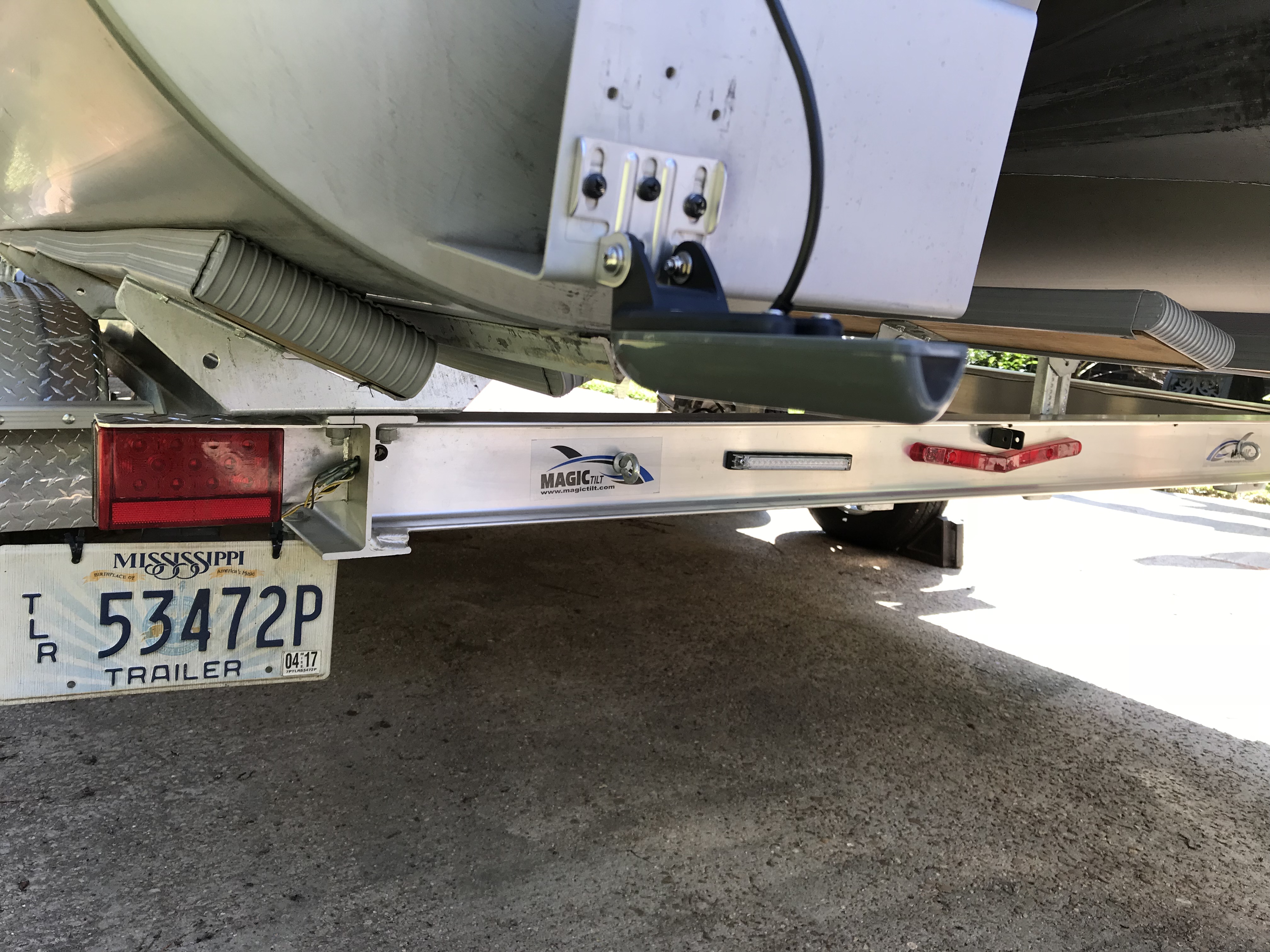

I'll take a pic or video of mine in motion. It didn't work when I first got my boat because it was mounted up so high that the toon was blocking the water, and yes, creating a "dirty water" situation. I'm certainly not arguing the point; just telling that mine didn't work, but after lowering it, it works at any/all speeds that my boat is capable of running, which is a little over 36 MPH.
This is where mine is mounted now. Notice the three holes where the dealer had it mounted. I also have it angled to compensate for the angle of the boat as it rides.

Hey Spoiled, mine is in the lowest position it will go but I'm guessing it's not as low as yours. Looks like I have something extra to look forward to next spring, the possibility that it might yet work!
BTW, that Mississippi plate is throwing me off. I thought you hung out in S. Georgia...
Well, I hope your wait, and attempt at a lower spot for your transducer will pleasantly surprise you. Let us know if it works for you. I'm still thinking it will if you go as low as mine is. Good luck! ;)
When I took it back to the dealer to get the motor raised, the first thing they said was, "if you hit something with that, it might break it off".
I told them that I'd much rather it work like it's supposed to and break it off in an accident, than have no idea how deep the water is, or is getting, and break off the lower unit of my motor. I believe they got my point. It's on a pivot, so if I hit something, it will most likely just pivot up and out of danger, but that would still be a concern very low on my list.
