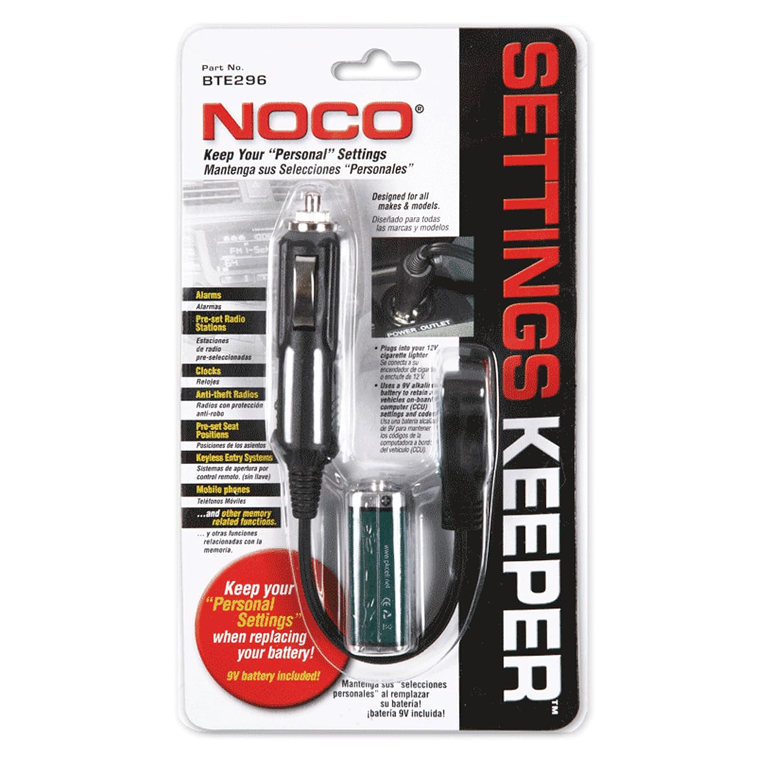

I don't think that 9V battery will last very long.... I thought about doing it that way but after looking at power draws it didn't seem practical for other than very short time periods (hours) not days.... I didn't research in depth so I could be wrong.
Since we go out everyday ( weather permitting ) . Not sure if it will be an issue for us  .Price is right for a test .
I do have solar a charger for my phone . I wonder if I could make that work .

Just read the specs on the KMC10. Looks like it holds settings in memory even without any power to radio.  Nice to know. Also has low battery alert.
Glade you replied SemperFi.  We ordered ours with a KMC10, so its nice to know we'll be covered come spring.
