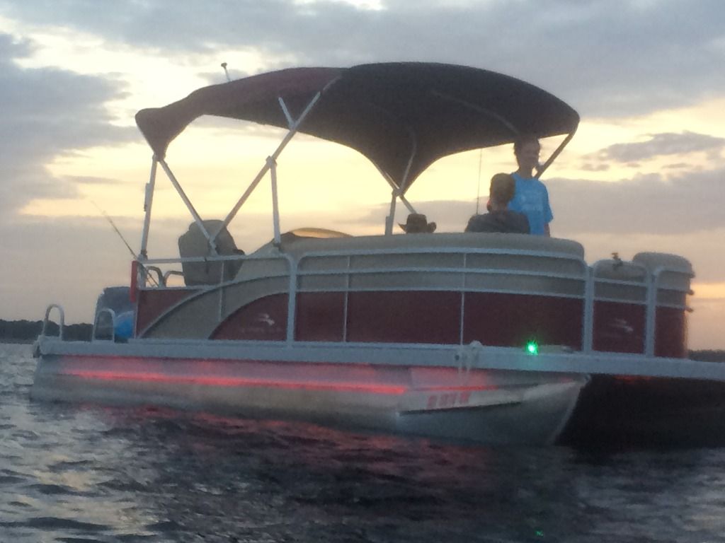

I finally got my new toon lights installed as well as my second battery. Hooked up to the live well switch and works just right. That's for the help.
Where's the pics?     :rolleyes:
The pics are coming. I wanted to get the pics of it on the water. I'm hoping they look as good as I'm expecting, but we'll see.
This doesn't do it service since it's not dark enough to get the full affect.
Here's one from our 70 mile river run on Wednesday.
Confusing running with red lights on the starbord side... Eventhough I had the lights, the more boats I see with light strips on the sides and in the stern the more I understand why the USCG does not like them.
Still looks cool!
I don't use them while in motion so even if the law doesn't like them, there shouldn't be a problem with mine.
I had to change the location of the hook up from the live well switch to the acc switch. The live well breaker kept tripping if I tried to move with the lights on. I haven't had a problem at all with them on the ACC switch. Maybe that live well breaker is very small or very weak. Anyway, I won't be using it again. It's going to get a free ride.
 I always have my lights on for night cruises and have never been stopped.  In 2012 I think I may have been the only one with side illumination but now they are a dime a dozen and still haven't heard of anyone pulled over for the lights
