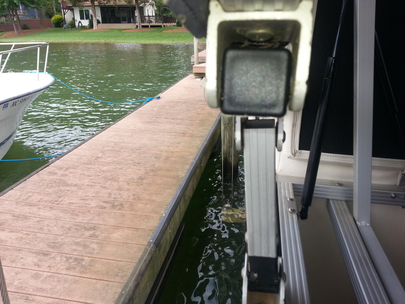

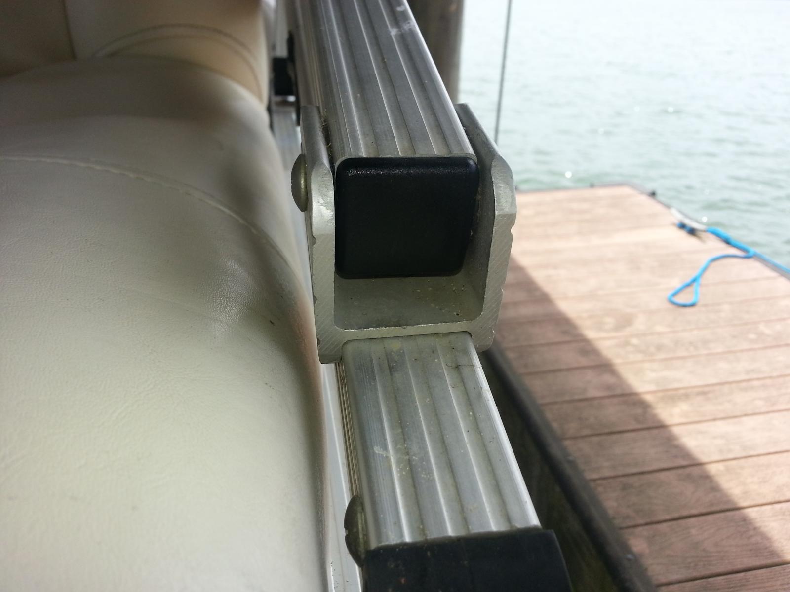

WOW! ... those plugs look great! After looking at the web site there seems to be all kinds of them ... any details on the specifics of which are the exact ones that work inside the rails of a Bennington?
THANKS!
I found all of my caps on Ebay. But it required two different sizes. For the Main Bimini support, which is a thicker guage square tubing than all of the rest, I needed the smaller square cap (1-1/8”). For all of the rest I used the 1-14” Caps. The photo shows the Ebay description for the two different caps.
Also, I had to trim most of the caps where the bolts were as the cap was deeper that the depth of the bolts. This was easily done with a box cutter. Hope this helps.
Thanks for the reply about some caps on Ebay, but I was hoping for details on the specifics of which are the exact ones that work inside the rails of a Bennington from Carl & Suzi who posted about the https://www.mcmaster.com/standard-cap-plugs
THANKS!
I'll have to measure if it's not raining tomorrow.
1 3/32" Looks like these: 9565K53
