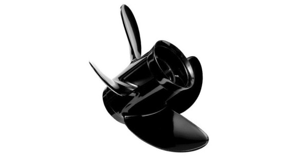

Current prop I'm running is a 13.5X15-K. Any thing above 5000 RPM feels as the boat is slowing down and sounds like the prop is cavitating. Tried at different trim settings, no difference. Any ideas? Also, lost my rear nav light cover due to low bridge. Light still works, just need a cover.

wonder if your motor is mounted too high on the transom, usually motor cavation plate should be flush to 1 inch below the water flow feeding the prop at full speed. You might want to try it with all your people load in the rear of the boat. You have never stated what type of payload you had on the boat when this happens.

Check the prop hub - could be spinning under heavy load. You will prolly have to take it somewhere that has a shaft to hold it with. If you try spinning it on your outboard you will just turn motor over.
The hub can be easily replaced in some props.

!5 pitch sounds like too much for a 90 hp engine. I think you would be better in the 11-13 Pitch range. When I had my 115 HP Yamaha, I went with 13 Pitch 4 blade Nemesis aluminum prop made for pontoons. It performed great.

The comment just above is spot on, except it isn't that the 15p is too much, it's that the k-series prop is a poor choice for a pontoon boat! Way too much slippage, just as you are getting big-time at high power. Same is true of the 13 through 15p K's that I tried (except one of the 15's, not sure what it's deal was...could only get about 4200 RPM). Anyway, switched to the pontoon specific 4-blade Nemesis 13p almost two years ago. I doubt there is a better prop for boats/motors like ours, although certain other 4-blade props may be just as good! We pull the Nemesis at a nominal 5500 RPM, so you would have some headroom if your VMAX has a bit more highend HP.

The K-series is Yamaha's standard small-case (4 1/4") 3-blade aluminum prop. No telling how many of those are out there, but they are not a great match for the high drag/low speed of a modestly powered pontoon boat. I expect they work well enough in other applications....
BTW: here is a general rundown of the various Nemesis props (they are typically just a lower cost twin of the Merc Spitfire). Note the pontoon recommended version is the 10-13p small case. I liked the performance so well that I bought a large case version (4 3/4" 23p) for our 190 Hp Stingray (although it has been tweaked a little). Works very well there too as an all-around low-cost aluminum prop. To be sure, nothing is going to dethrone the Merc Hi5 as the best pulling prop! I'll be putting that one back on for the 4th.

Update to my prop issue. Thanks for all the replies, but I have a little more info. Benny 20sv, Yamaha 90hp SHO. Current prop 13.5X15-K.
40004pm, 1/2 trim 14mph
5000rpm, 1/2 trim 19mph
5800rpm, 1/2 trim 22mph
WOT, 6200rpm after hitting rev limiter (7000) 23mph
Smooth water, no load
with 8 people:
5000rpm - 17mph
WOT 5800rpm after hitting rev limiter 18mph

That's similar to what we had with the original 13p K-series. Both the 14p and the 15p (still have that one) ran calculated slippage of more than 30%. That all changed with the 13p Nemesis Pontoon prop. Yesterday, with 7 aboard and a bunch of gear we ran ~5200 and ~21 MPH. With two on a medium inflatable (one adult and one 6-year old) and in a hard turn the WOT RPM would drag down just under 5000 (could get about 18 MPH straight-line towing).
I don't use trim as you do... Likely our transoms are a bit different and I rigged an extra 2 degrees of tuck under (negative trim). I use no trim unless the bow is heavy or above ~15 MPH.
P.S. Never hit the rev limit even with light load unless I (purposely) trim out way too far. Max RPM is ~5500 with light load.
