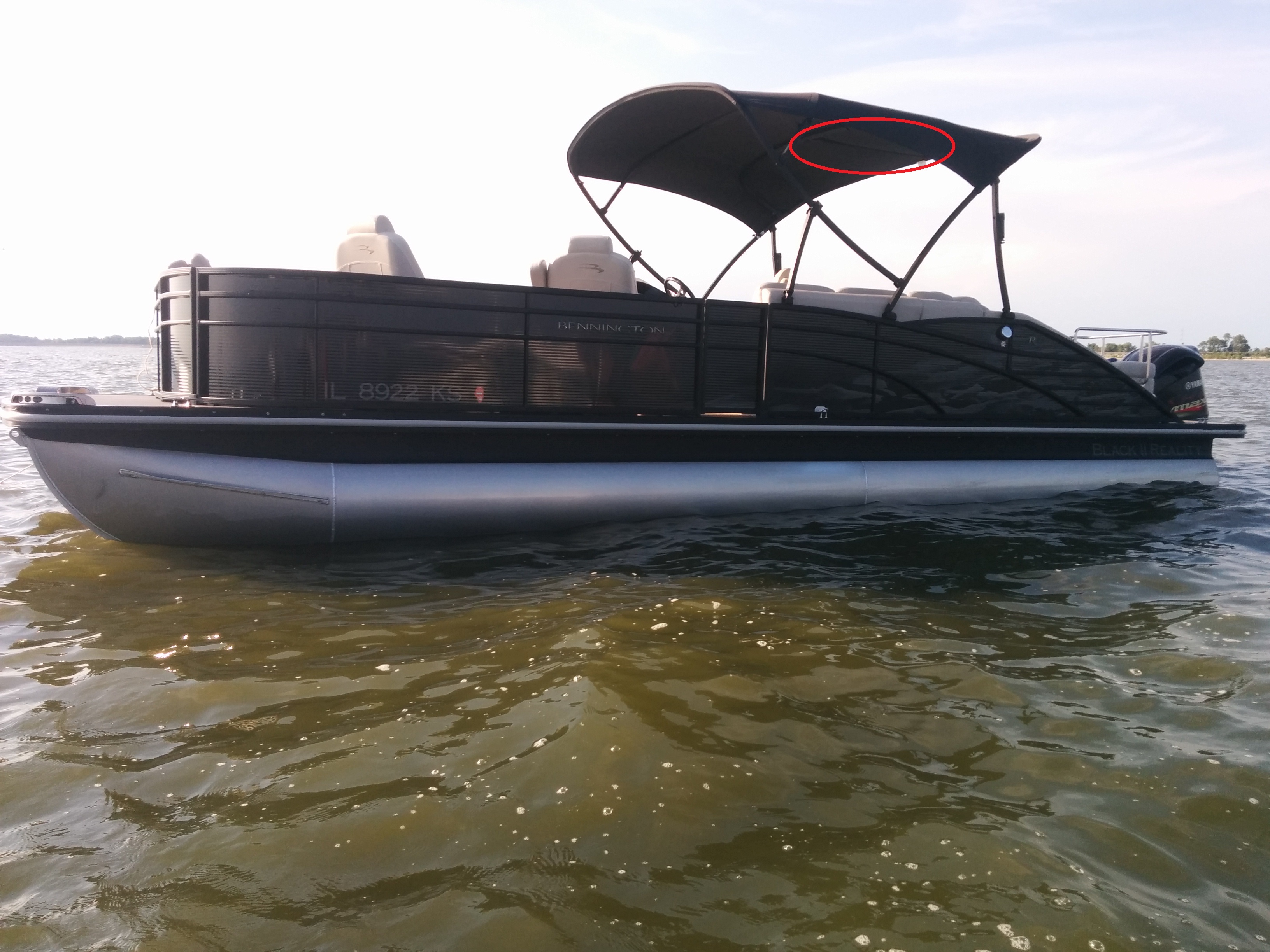

Just happened to think that I might have an old photo on my computer and we're in luck.
This shows the proper fitment of the curved bimini fabric with proper placement of the side strap snaps. The red oval (look closely) shows the proper installation of the adjustable 2-piece strap (it has a snap hook on one end) that pulls the 3rd bow back towards the last (4th) bow. This prevents the rear bimini fabric from dipping downward at speed.
