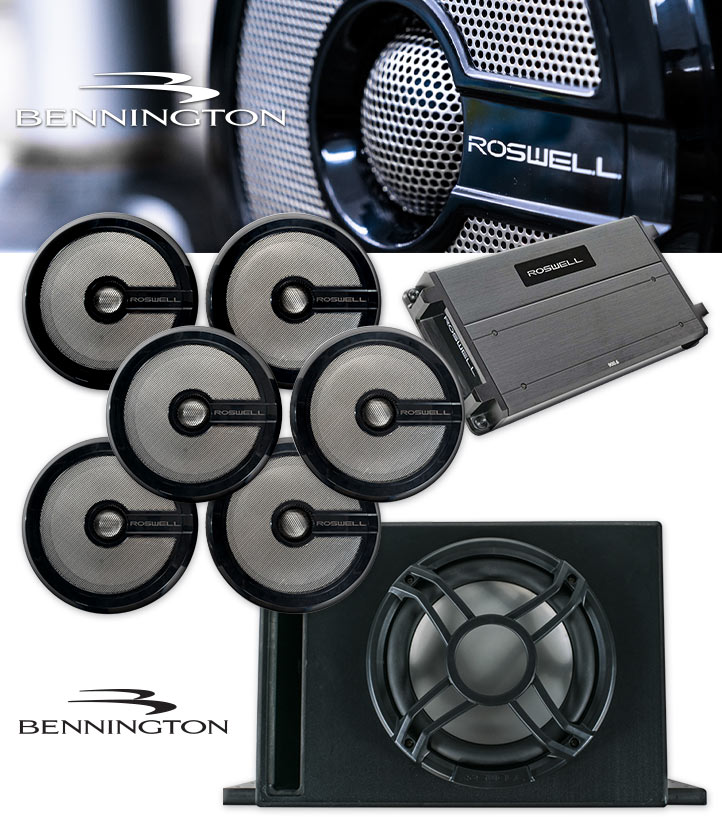

Hey guys. The site doesn’t seem to give much info on the Roswell upgrade. Can anyone tell me what speakers, amp, sub etc is included? Love to know how powerful this system is and learn about all its components. Thanks.

This is what the info button beside the option on the builder page says:​
Step up to a premium audio package purpose-built and tuned exclusively for Bennington and a pontoon boat's unique sound stage. Every Roswell component has been specifically designed, engineered, and tested to ensure peak performance in freshwater and saltwater marine environments. These are not just another off-the-shelf audio kit, but a custom-tuned piece of a musical masterpiece. All Roswell components are Klippel tested and certified to guarantee acoustic performance. What you get:
6.5" Roswell R1 In-Boats Speakers* The R1 speakers are purpose-build and tuned to maximize performance and durability for our application. Equipped with an exclusive Bennington grill with integrated RGB LED lighting, high-output woofers, and separate tweeters, these speakers will surely please any crowd. Sit back, relax, and ROCK ON. *Fiberglass Fastback afts step up to 2 - 8" R1 speakers. Cladded arch models will include 2 additional 6.5” R1 speakers.
Roswell R1 10" Subwoofer & Custom Enclosure An R1 subwoofer is paired with a custom-engineered enclosure tuned exclusively for use on a Bennington pontoon boat. These woofer's low-ends deliver a high-fidelity listening experience for any musical genre you and your family enjoy. Go ahead, feel the sound.
Roswell Amp* The Roswell R1 amplifier is perfectly matched with the R1 speakers and subwoofer. This amp pushes out incredible high current power, ensuring crisp, clear output at any volume. *Models with fiberglass fastback afts include a second amplifier
