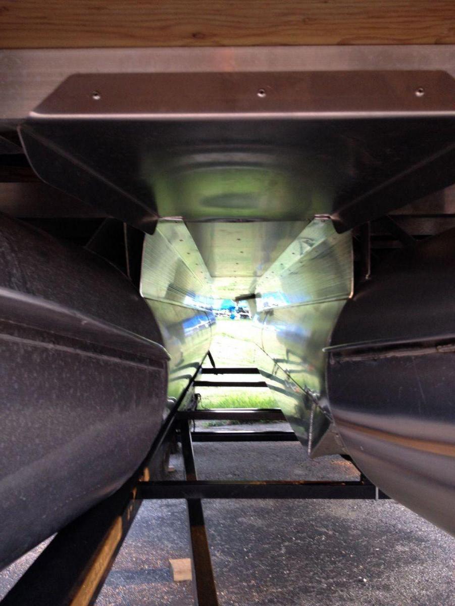

Bennington's "Wave Tamer" isn't a completely sealed system. A shield directs water from the top of the tube area, but doesn't completely seal them off. I believe that the Wave Tamer is available on 2 tube and Express tube boats only. The full underdeck wave shield does with the SPS and ESP hulls. The 2018 brochure doesn't really help to define or show the differences, so you will need to lean on the dealer to find you the info you seek. Or, get a better qualified dealer.
Here's what the full under deck shield looks like on a boat with the Express Tube. Note you cannot see the "w" brackets at the top of the tube with this shield. The "w" brackets are visible with the Wave Tamer.

Here's what the full underdeck shields look like on a 2016 boat with SPS.
